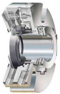

A typical gas seal design will use hydrodynamic lift-off to separate the rotary and stationary seal faces. Spiral grooves in the rotary seal face collect the gas. As the seal rotates, gas is compressed towards the end of the groove creating an opening pressure. This pressure exerts an opening force greater than closing force, separating the seal faces. This slight separation allows the gas to flow across the seal faces. Thus, the seal faces ride on a pressurized, gaseous fluid film (Figure 1).
Figure 1. A cutaway drawing of a compact gas seal.
Inexpensive and inert nitrogen gas is typically used with gas seals and gas consumption is a function of differential pressure between the process and regulated gas supply pressure.
