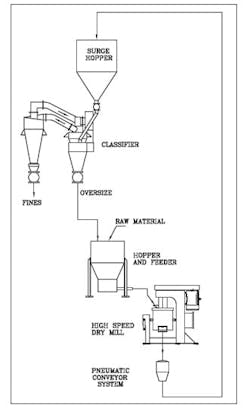

Closed Loop
Figure 5. Oversize material is separated and then returned to the mill.

Dry grind mills can be used in conjunction with air classifiers or screeners to form a closed grinding process loop (Figure 5). By continuously classifying out fines and returning oversize material to the mill, such systems can very efficiently provide sharp particle-size-distribution grinds.
