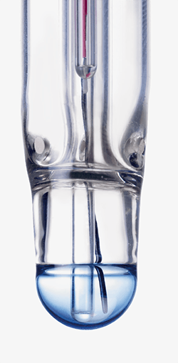

A basic glass electrode comprises an inert glass stem sealed to a bulb or membrane made from a special glass formulation that is responsive to hydrogen ions. The pH measurement results from an ion exchange process that takes place between the hydrogen ions in the solution and the ions at the surface of the glass membrane. This develops a charge on the membrane surface that then is transferred through the membrane where it is picked up on the inner surface.
The glass electrode (Figure 2) contains an aqueous internal filling solution of a known pH along with a silver wire coated with silver chloride (AgCl), which is called an internal element. The immersed element allows for electrical continuity with the inner surface, thus affording an electrical connection back to the pH meter.
To complete the electrical circuit, a reference electrode provides a return path to the sample solution. Reference electrodes come in various designs but a typical construction uses an AgCl-coated silver wire immersed in a potassium chloride (KCl) solution. This offers a stable environment for the reading but, equally important, allows for an electrical continuation between the pH electrode and the sample, thus completing the circuit.

Figure 2. The pH sensor contains an aqueous internal filling solution of a known pH along with a coated silver wire called an internal element.
