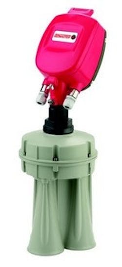

BinMaster Level Controls introduces the new BinMaster RL level sensor designed to provide reliable bin level data in challenging environments where dust levels are extremely high. The non-contact, continuous level sensor works in powders and solid materials of all types, including very low dielectric materials, which until now have been largely incompatible with non-contact devices.
The acoustics-based BinMaster RL features a self-cleaning, non-stick surface that does not require routine maintenance or air purge for cleaning. This eliminates manual cleaning of the sensor and frequent climbing of bins, which is a safety hazard. It uses acoustics-based technology at very low frequencies, which allows it to penetrate dust. The acoustic waves won’t reflect off heavy dust or the material surface, which can cause erratic or inaccurate measurements. In addition, it performs consistently when the environment gets extremely dusty, such as during filling or emptying cycles.
Multiple bins can be connected using a daisy chain to help save on wiring and installation costs. The BinMaster RL outputs a 4-20 analog signal for simple connection to an existing control system or display module. Users can view measurement data for one bin or all bins at once from a PC when the RL is used with MultiVision software.
