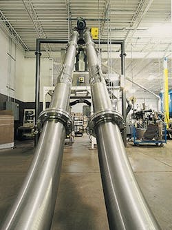

SUITABLE FOR CHALLENGING MATERIALS
8-inch Tubular Drag Conveyor elevates product into hopper for packaging.

A: Yes, we team up with customers and look at the materials they need to convey. A lot of other conveyors, they can tumble the material as it’s conveying, such as a screw conveyor. With pneumatic conveyors, there is high velocity — those speeds and that tumbling action break down the materials and the material can stick within those components. On a tubular drag conveyor, the material will come into the inlet and it sits between two plastic flights, typically made of UHMW [ultrahigh-molecular-weight polyethylene] and the material sits static between those flights and it moves through the system to the discharge point. Product captured between flights is moved en masse exposing it to very little turbulence during its transfer. Only a small percentage is ever in contact with the pipe wall minimizing the potential for abrasive degradation.
Q: Are there other special design considerations?
A: Many times when you get into a difficult-to-handle material and if it is explosive, you want to be dust-tight and odor-free. In the tubular drag, it’s totally enclosed, and it offers those things. With it being fully enclosed, we protect the workers from the hazardous dust, fumes and odors. Not to mention, the high torque operation of a tubular drag gives it the ability to stop and start under full load removing the need to handle the material once loaded into the conveyor.
Another great feature of the tubular drag is it can navigate around different objects. What has traditionally required two or three conveyors can often be accomplished with just one tubular drag conveyor. The ability to convey through bended pipe makes it possible to route conveyors through layouts requiring changes of direction.
Additionally, tubular drag conveys vertically. In crowded plant environments, the ability to convey vertically is a game changer. Suddenly retrofitting a vital new process into the middle of the plant is made possible by a conveyor that can receive material and immediately turn upward, conserving valuable floor space.
