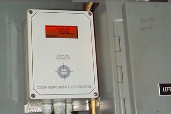

Consistent But Wrong Readings
Figure 1. The readout remained the same because the probe had failed.

The cost numbers just cited underscore that controlling the dryer on dew point can reduce operating costs significantly if the dryer is experiencing lower-than-rated moisture loading (cooler temperatures and less flow). The typical dew point controller has some sort of humidity probe and an onboard display so operators can monitor the output of the dryer. This probe requires adjustment and calibration, points too often forgotten.

A paper plant can attest to problems caused by ignoring dew point instruments. At the site, regular hourly operator checks included recording the dew point readout. The operators dutifully wrote down the output reading as -70°C (Figure 1) over and over again for months. Yet an auditor checking the after-filter on the dryer found it full of water (Figure 2). The auditor confirmed the problem by removing the dew point probe from its measuring cell and waving it around in the steamy compressor room; the failure mode of the probe resulted in a continuous display of the same reading regardless of actual conditions.
A similar incident happened at a gypsum board plant with an externally heated dryer. The device was sized for two 150-hp compressors but only one compressor normally ran. This meant the dryer was greatly oversized for average flow. In addition, ambient conditions were cool and dry, reducing the moisture load to about 20% of rated conditions. However, data loggers monitoring the dryer cycles showed the unit was purging at almost full rated duty. The dew point readout appeared normal — until a second, recently calibrated meter was placed on the system and the readings compared. The onboard probe had become damaged and was reading 20°F higher than the actual level. The dryer was achieving -55°F dew points but the onboard meter read only -35°F. This failure prevented the dew point circuitry from turning off the purge, causing the device to consume five times more power and compressed air purge flow than necessary.
These failures point up the need to regularly calibrate dew point instruments as well as the value of a portable meter in detecting problems.
