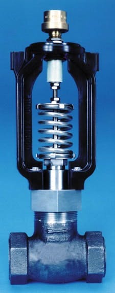

5. Equip steam tracers used for freeze protection with temperature-actuated valves. Application of these valves in an on/off operating strategy helps reduce costs by using the steam tracer only when required. For example, a small group of tracers could be controlled by a valve that would open when ambient temperature falls to 5 Degrees F above the process freezing point and close when ambient temperature rises to 10 Degrees F above the freezing point. Figure 2 depicts such a valve.

Figure 2. Self-contained on/off valves such as this one enable users to employ tracing only when necessary.
Source: Ogontz Group
