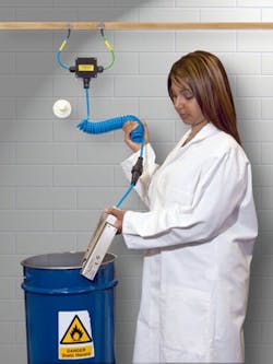

Assured Protection
Figure 1. An intrinsically safe, self-testing grounding clamp visually indicates proper functioning.

Even when the appropriate static safety equipment has been specified, those responsible for operations within hazardous areas must address some additional concerns. In operational terms attaching a grounding clamp to a plant object is always a "physical" action. Even if diligently following company recommended safety procedures, an operator can never know whether the clamp has made good enough contact with the object to safely dissipate any static generated before it can accumulate to dangerous levels. Lots of conductive objects capable of accumulating high static charges also have insulating layers — e.g., paint or a coating or even product build-up — on their surfaces that may prevent this low resistance contact. Many common grounding and bonding clamps show very high resistance readings when clamped onto conductive objects with insulating surfaces. The problem can be even worse if a plant uses standard welding clamps or lightweight alligator clips in place of purpose-designed devices.
To solve these problems, use intrinsically safe, continuously self-testing grounding clamps (Figure 1), as recommended in NFPA 77. An operator employs these in exactly the same way as conventional grounding clamps.
These devices employ certified, active electronic monitoring circuits powered by a low energy battery. The circuit only is completed when the clamp achieves a low resistance contact onto the object to be grounded; the operator receives visual confirmation of this via a light/indicator (usually a pulsing LED). The self-testing grounding clamp also monitors cable condition back to the designed ground point, and won't give the visual go-ahead if the cable has worked loose or is broken. Clamps for use in hazardous locations should carry the appropriate certification or approval mark, e.g., from Factory Mutual (FM) or the Canadian Standards Association (CSA).

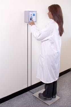

Shoe Tester
Figure 3. Device provides an easy way to check that static dissipative shoes remain effective.

A static safety audit also requires us to consider the people working in the hazardous area. If the human body is insulated from contact with the ground, either by nonconducting shoes, insulating floors or both, static charge can start to accumulate as the person walks along the floor. After just a few steps, a fairly high potential may develop (especially in low-humidity atmospheres); if the person then approaches a conductive material at either ground or a lower electrical potential, a spark may occur. It's generally thought such sparks can reach energies as high as 30 mJ, sufficient to ignite almost all flammable vapors and gases, and many sensitive combustible powder (dust) atmospheres. These sparks can be avoided by using ground wrist-straps for sedentary workers, or static dissipative (SD) safety shoes for personnel who need to move around to carry out their tasks. In the case of the latter, it's also necessary for floor materials to be sufficiently conducting to allow a "ground leakage" path to safely dissipate any static charge as each foot contacts the ground.
In the U.S., SD footwear is manufactured according to ASTM F2413-05, which specifies maximum and minimum levels for ground leakage via the shoe. Leakage should be low enough to allow static charges to relax to ground but high enough to provide some protection against electric shock. SD footwear can be checked for ongoing effectiveness using test stations (Figure 3). These types of devices help prevent incorrect shoes being used in static-sensitive environments.
