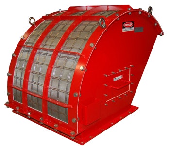

Flameless Explosion Vent
Figure 1. Layers of stainless steel absorb heat generated by combustion, allowing venting without flame release. Source: Fike.

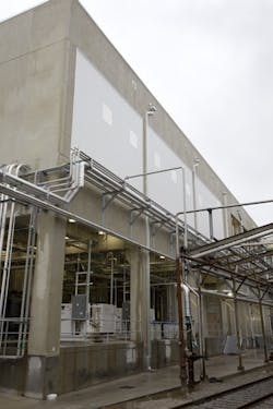

Blowout Panels
Figure 2. Rebuilt Port Wentworth, Ga., sugar refinery now contains such wall panels for fire and dust safety. Source: Imperial Sugar.

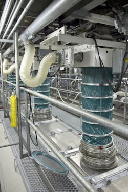

Dust Collection
Figure 3. Sugar-refinery rebuild also included this dust-collection system. Source: Imperial Sugar.

For Fike, whose business centers on supply of explosion-protection and fire-suppression systems, all this regulatory activity is spurring product development. The company relatively recently introduced rectangular flameless explosion vents (Figure 1). It's working on faster-responding suppression devices because speed is key when dealing with a deflagration. "Our systems must detect the combustion event and inject a chemical suppressant in a matter of milliseconds. From time of detection to full release of the suppressant happens typically in less than 50 milliseconds. It takes approximately 250 milliseconds to blink your eyes, for comparison."

The rebuilt refinery also features wall blowout panels (Figure 1), dust collection systems (Figure 2) and explosion suppression devices (Figure 3).
