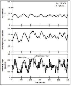

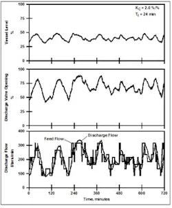

Figure 2 presents the performance for the following tuning: Kc = 2.0 %/% (a modest amplification of the measurement noise); and TI = 1.33 min (the same as suggested by the tuning equations).
The previous article demonstrated this tuning produces a cycle in a noise-free environment. Figure 2 depicts a similar cycle. The variability in feed flow makes the cycle more difficult to quantify. However, especially in the controller output, cycles of a sinusoidal nature are evident in most intervals of the response. The 12-hr period covered in Figure 2 shows at least 26 distinct peaks. This suggests a period (P) of 720/26 = 27.7 min. Arbitrarily selecting two of the peaks gives a period of 18 min. In either case, a reset time of 1.33 min is far too short  --  TI should be at least half the period of the cycle.
Sinusoidal Cycles
Figure 2. At least 26 peaks occur over 12-hr period.

Figure 3 repeats Figure 2 with a TI of 24 min, which hopefully is close to the period of the cycles in Figure 2. Consistent cycles of a sinusoidal nature no longer are evident in the vessel level or controller output. However, this comes at a cost. As the controller is made less aggressive, deviations in vessel level from its set point (SP) increase, as shown in Table 1.
Reducing Kc has a larger adverse effect on performance than increasing TI.
