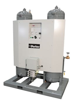

PSA GENERATOR
Figure 2. Carbon molecular sieves enable achieving 99.9%-pure nitrogen.
