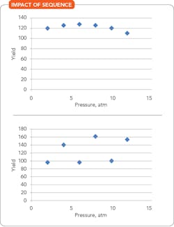

Whenever possible, randomize the manipulation of factors. The example shown in Figure 1 demonstrates why this is important. Let’s suppose we’re testing a catalyst for making product at various pressures. In this case, it’s a lot easier when running experiments to start at low pressure and then progressively raise the pressure. Ordering the experiments this way provides the smooth curve shown in the top graph in Figure 1 and leads us to conclude that the optimum yield occurs at around 6 atm. What we didn’t realize was that catalyst activity was decreasing with time. Running the test in random order of pressure gives the graph shown on the bottom of Figure 1. It clearly indicates that one or more factors besides pressure are playing an important role.
Impact of Sequence
Figure 1. Runs covered in the top graph used progressively increasing pressure while those in the bottom graph randomized the order of the pressure.
