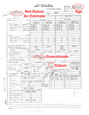

Figure 1 shows part of a specification sheet for a shell-and-tube heat exchanger. The tube count is a datum. However, the duty isn’t a datum but the result of a calculation. Actual exchanger performance will vary.
Heat Exchanger Data Sheet
Figure 1. Check the date of the sheet and consider the nature of the entries before troubleshooting.
When troubleshooting or modifying a plant, far too many conversations include the remark: “The data sheet shows the heat exchanger will do so many BTUs per hour.” You can substitute tower capacity, pump head, filtration rate, NOX release and lots of other parameters for equipment performance. However, unless the equipment has been put through a test, the performance values shown on the data sheet only are estimates. Modern pumps, compressors and burners tend to have reasonably good estimates. Heat exchangers, distillation equipment, separators, filters, centrifuges and many other types of equipment often perform much differently than “expected.”
So why does performance vary from that listed on the specification sheet? Figure 1 highlights some issues:
Age. The sheet was filled out in 1977. We do have better methods for estimating exchanger performance today — especially for complex systems with phase changes.
Guesstimates. At the specification stage, estimating the fouling factor is guesswork for many heat exchangers. For troubleshooting, you must know the real fouling factor; it may be much higher or lower.
