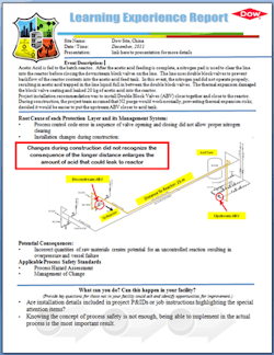

Learning Experience Report
Figure 2. This single page format is simple, direct and broadly applicable.
An RCI can range from informal discussions among two or more people knowledgeable about the incident to more formal techniques like cause-and-effect charting, five whys, failure mode and effects analysis, fishbone diagrams, etc. Effective corrective and preventive actions resolve not only the specific failures but also system and strategy level failures to avert repeat events (or similar events associated with the same management system failures).
Gathering of evidence such as process conditions, sequence of events and operator recollections before the scheduled review is essential. Such evidence enables generating a cause-and-effect diagram to identify the root cause. That diagram must show not only the direct cause(s) such as a failed instrument but also the underlying system cause(s) such as ineffective maintenance for the instrument. This then enables developing corrective actions to address all the identified root causes. The learnings about management system root causes and corrective actions typically are the ones that are most leverageable across a corporation.
With the RCI complete, an LER can be developed. Typically, this report will include the event description, the root causes and corrective actions. The impact of the lessons learned depends on the quality and effectiveness of the communication through which they are shared. We have found that summarizing the key lessons learned from any event into a single page LER containing direct and concise information eases communication beyond the facility that had the incident.
Figure 2 provides an example of an HP PSNM LER. Note that it does not include all of the technical details of what occurred during the event. Rather, the LER’s role is to give enough information to underscore the significant learnings value or the reinforcement of critical protection layers stemming from the event. Restricting the LER to one page provides a format that is simple, direct and easily transferable to a range of disciplines. The key content includes a brief description, root cause(s), consequence(s), what should have prevented the event and, most importantly, key questions to ask of the recipients of the report. For those recipients of wanting full technical details of the event, a link on the LER can point them to a separate document or presentation.
As with any event, the identified root causes are an important lesson. A picture or schematic of key elements of the process related to the event can contribute to an improved understanding of the incident. The LER should include the potential consequences of the event, e.g., chemical release, personnel injury or cost of equipment damaged. It also should highlight the corporate standards or industry best practices that, if effectively in place, could have influenced or prevented the event. Finally, the LER should present challenging questions for readers to ponder. This allows relating the event to their specific situations and so bolsters the opportunity to leverage the lesson learned beyond the boundaries of that single event. One or two questions can generate discussion or serve as a reminder when a similar topic arises.
