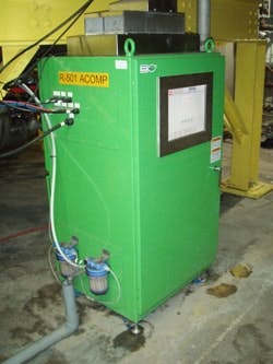

In 2016, Nalco purchased a second-generation ACOMP unit for another production line at Garyville (Figure 4). Even when maximizing reactor capacity isn’t an overriding issue as it is in boom times, ACOMP still saves energy and overtime, providing additional benefits. Based on feedback from Nalco, the second-generation ACOMP included important features such as autonomous operation tied directly to process operations (previously the operators had to start and stop ACOMP’s measurements) and the ability to physically locate the unit close to the reactor, important for addressing shop-floor space constraints. The second-generation system has been running continuously with average on-stream efficiency exceeding 95%.

Figure 4. Unit installed at Garyville, La., plant includes several significant enhancements.
