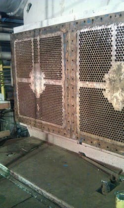

Condenser Inlet Tube Sheet
Figure 1. Failure of just one of the numerous tubes used can contaminate the condensate. (Water box removed to show tubes.) Source: American Exchanger Services.

Process water quality data, including readings from the steam generators and condensate return, where applicable, also are important. Impurities can enter these streams from many sources. For example, heat exchangers that operate with process fluid at a higher pressure than the steam heating supply may introduce a variety of contaminants to condensate. Turbine exhaust steam condensers are a common location of impurity ingress; they typically contain thousands of tubes (Figure 1) and even a single tube failure allows cooling water to enter the condensate.
