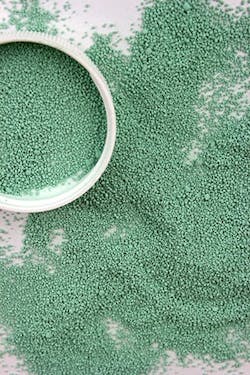

Micro-Pellets
Figure 2. A pin mixer, because of its intense spinning action, yields small, dense pellets.

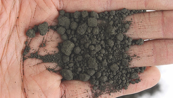

Conditioning. This generally is considered as blending a liquid component, binder or water with a solid feed to de-dust the material or roughly agglomerate it.
Conditioning often serves to de-dust fine materials such as ash, either for a beneficial reuse application or deposit into landfill. Sometimes, producers can consolidate waste management by using a liquid byproduct or waste as the liquid component for de-dusting. In such cases, blending the solid and liquid material can create a stabilized mixture for disposal.
Conditioning typically occurs in a pugmill (paddle) mixer but pin mixers and granulation drums are alternative options.
The conditioning approach is best for settings in which specific granule properties are not important. The objective may be to roughly agglomerate (Figure 1), homogeneously mix, de-dust, or even increase the material’s bulk density. This option is a favored approach for processors looking for a quick and straightforward way to de-dust their material.
Micro-pelletizing. This is a more-refined version of conditioning in which the goal is not only to de-dust the material but also to produce small, uniform agglomerates, often with a higher density.
Micro-pelletizing is chosen when it’s necessary to achieve certain granule properties, such as particle size distribution and bulk density, from ultra-fine materials. This technique is standard practice in the carbon black industry and also widely used in processing coal dust and clay fines.
Micro-pelletizing typically takes place in a pin mixer. Such a unit can produce small, dense pellets (Figure 2) thanks to its intense spinning action. A disc pelletizer (pan granulator) also may carry out micro-pelletizing, but the resulting pellets are larger and not as dense. In addition, homogeneous mixing does not occur with a disc pelletizer, unlike with the pin mixer.
