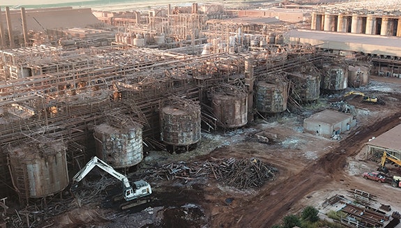

A number of steps are crucial prior to mothballing or demolition and site restoration
A plant can face shutdown for a variety of reasons, from poor economics due to outdated equipment or no-longer-competitive processes to product obsolescence. The last steps in the life of such a plant are decommissioning and demolition. These steps demand the same manner of organizing and executing as a design-and-construction project with special emphasis on personnel safety and environmental compliance. Figure 1 shows demolition underway by the Frontier Industrial Group at an aluminum-oxide facility in Gregory, Texas. The project to decommission and demolish the plant illustrates the complexity of the task. The environmental remediation, decommissioning, asset recovery and demolition work required 20 months. Frontier utilized barges to ship scrap metals generated during the demolition phase to steel makers in different parts of the country. The company explicitly made workplace safety the project’s number one priority.
Decommissioning may occur in preparation for either mothballing or demolition. Mothballing refers to putting the facility in an idle state or temporary shutdown in a manner that allows restarting later when the business environment makes the process attractive again.
Mothballing, while buying time for decision-making, can be surprisingly expensive. Idled assets still need attention from maintenance and other staff. (Remember: “rust never sleeps.”) In addition, items such as control systems’ hardware and software can become obsolete over time. Mothballing requires its own specialized operating procedures and documentation, safety reviews, etc. Moreover, it can pose significant safety issues, due to manual operation of equipment. For additional information about mothballing, see References 1 and 2.
Cleared Site
Figure 2. Bare ground soon will mark where aluminum-oxide plant stood. Source: Frontier Group.
The alternative to mothballing is decommissioning, followed by decontamination for partial salvage or demolition to permanently remove the facility. Partial or “surgical” salvage refers to dismantling assets specific to the process but keeping other parts of the facility. For example, the site may decide to tear down specialized solid/liquid separation or drying equipment but retain a reactor that can be used for a different process. During partial salvage, piping reconfigurations as well as control and instrumentation changes also must be considered as these may cost more than a new “normal/standard” installation. The scope definition requires a formal phased project-engineering approach. Any “surgical” demolition is expensive.
Decommissioning in preparation for mothballing can differ greatly from decommissioning in preparation for demolition. For instance, in the case of mothballing, decontamination to strict standards generally is unnecessary because personnel exposure is not an issue. Corrosion, inerting, lubrication, etc., are key concerns.
Decommissioning For Demolition
For demolition, the site is taken “down to the slab” for site restoration. All items, including the structure, are removed, for sale either for reuse or scrap. Expensive alloy items such as those made of tantalum, Hastelloy C, etc., invariably are targeted for reuse. Figure 2 shows the Frontier work at the site in the final stages of the project. In general, plant owners do not get involved with reselling of equipment. Instead, the demolition contractor’s cost is adjusted by the estimated value of the equipment (as scrap or recovery), structural steel, etc. Specific spare parts no longer needed also should be salvaged or sold through a third party well-versed in the particular market. In general, recovered values only amount to 10–25% of the new item cost.
