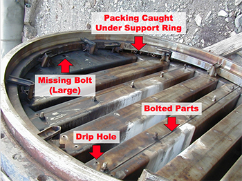

The experience of a site that bought a surplus 42-in.-dia. distillation tower exemplifies what can go wrong. That packed column, which had been built at a pharmaceutical plant but never placed into service, had sat idle for years. The tower was sold without any documentation on its internals; no mechanical or process details were available on internals configuration or original design rates, conditions or physical properties.
The tower was loaded horizontally onto a truck, shipped well over a thousand miles to its new home, unloaded and then erected. At no time, did anyone inspect the column’s internal condition.
The tower failed to perform on startup. Troubleshooting quickly ran into hurdles: What were the internals? What range of liquid and vapor rates could they handle? What was their mechanical condition? No one knew.
Deficient Liquid Distributor
Figure 1. A variety of issues severely degraded the performance of the random packing underneath.
Disassembly of the tower revealed many problems. For instance, the liquid distributor (Figure 1) had very small diameter drip holes; it was designed to handle a much lower liquid rate than the process needed. Second, the distributor had mechanical flanges; this is a low-budget configuration, cheap to make but highly susceptible to leaks that degrade performance. Third, bolts and hardware were missing or perhaps never were installed; this left large holes that would pass lots of liquid and significantly undermine tower performance. Fourth, the tray had come loose from its support ring during transport and some packing had become wedged underneath. Most liquid wouldn’t go down the distribution holes but would leak at the edge of the tower. This dreadful liquid distribution meant the packed bed underneath achieved less than 10% of its possible performance. Finally, the migration of packing to under the distributor also showed that the random packing supports and hold-downs had severe problems.
The plant had to remove and replace all the tower internals. The tab for this made the total cost of the used tower exceed that of a new one. Additionally, the time required for the repairs eliminated any schedule savings.
