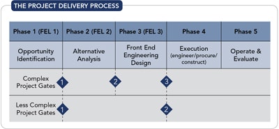

The Project Delivery Process
Figure 1. A small project should involve fewer phase gates.
Think about a large upstream project such as an offshore platform involving a jacket, drilling, topsides, tie-back operations, extensive use of supply vessels, transport and heavy lifting of equipment or whole units and facilities. An operation of this magnitude demands careful planning, design, coordination and integration of thousands of components, many of them fabricated and transported from different parts of the worlds. The specifications, drawings, procedures, etc., to completely define each component and the procedures for assembling, commissioning, starting up and testing such facilities are extraordinary. Each deliverable should be carefully developed at a very high level of detail following protocols (project assurance) that repeatedly, and in a timely manner, check the planning, quality of the design, constructability and integration of the facility. Such protocols include conducting independent reviews, readiness assessments, benchmarking, safety reviews, integrity reviews, as well as extensive use and application of value improving practices (VIPs), just to name a few. If the components can’t be integrated, are late, don’t comply with specifications and standards due to failure in properly designing, specifying, following up, or installing any of the components, the facility won’t work. This will mandate extensive rework, additional financial resources, and more time for completing and commissioning. Time to market, expected revenue and profits, and competitiveness will suffer by using resources inefficiently and ineffectively. For these reasons, the development, control, quality assurance and timely integration of all the deliverables of major capital projects is of paramount importance; this calls for careful implementation of all the steps of a sound PDP in all its details.
On the other hand, small projects or ones with low complexity or limited technological challenges typically require more modest resources in terms of project team size and skills, contractor’s capabilities and financial resources. Some of these projects might even be executed in a similar or repetitive manner, or by applying just a limited number of project assurance protocols, considering the typical short duration of such projects. As a consequence, the number of deliverables to fully specify/design the project or its components is very limited. These small projects, because of their size or low complexity, are easier to visualize and understand.
