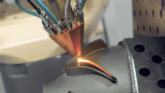

A Chevron USA refinery undergoing a routine maintenance shutdown earlier this year found that some needed replacement parts suffered from extended lead times and supply chain delays. So, to keep to schedule, the refinery switched from traditionally manufactured parts to ones made by Lincoln Electric, Cleveland, Ohio, using its proprietary 3D printing technology.
Chevron’s additive engineering team worked with Lincoln Electric and industry experts from Stress Engineering Services, Houston, to print eight nickel-alloy replacement parts that averaged approximately 3 ft in length and over 500 lb each. Printing the entire lot took just 30 days, in contrast to the quoted delivery time of several months for traditional parts.
“Lincoln Electric is vertically integrated, with significant production capacity in both printing systems and wire feedstock, and using our own software we were able to begin printing within a day of finalizing the components’ CAD files with Chevron — no waiting on other suppliers. In addition, we are located in the U.S., which eliminates long travel times from overseas and import delays,” says a spokeswoman.
“Chevron was actually able to incorporate design changes for improved performance and ease of installation — all of which were readily incorporated into our 3D printing strategy,” she adds.
Lincoln Electric’s 3D printing also has saved other plants significant time, she notes.
In one case, a plant conducting a routine inspection discovered that the bearing housing for a large mixer was damaged. It had no spare parts in inventory.
Lincoln Electric 3D laser scanned and reverse engineered the component, created a CAD model from which it could 3D print, and then printed a 625-lb steel bearing housing — all within two weeks. A casting would have taken a couple months. Importantly, the company was able to readily incorporate design improvements from the manufacturing engineers.
The company also 3D printed a redesigned steel blade for the same mixer; it incorporates large, conformal cooling channels that significantly improve heat transfer compared to gun-drilled intersecting holes that require weld plugs. The 3D-printed blade costs about the same as a casting and can be delivered several weeks faster. Moreover, it does not require a foundry to manage pattern storage and, thus, avoids the all-too-common problem of damage or loss of patterns or molds during storage, which often is not discovered until the next order is placed.
Lincoln Electric currently is 3D printing an 8,000-lb component for a flux extrusion line. Obtaining a billet of steel large enough for machining would take five to six months. The company anticipates completing its 3D printing in less than two months. In addition, it cites two more bonuses: the wire has higher strength than the cast iron, and 3D printing near net shape reduces machining time and costs.
The company expects growing interest from operating companies in 3D metal printing and foresees it becoming an established option for quick-turnaround replacement parts, buoyed by its acceptance by companies such as Chevron. Lincoln Electric also believes original equipment manufacturers will adopt 3D metal printing for new components as well as spares.
For chemical makers chary of the AM route, the spokeswoman notes the company’s 3D printed components are deposited weld metal — something well understood and already used in critical chemical operations every day. In addition, the company has extensive test data on the alloys it 3D prints and will generate more data in years to come. At the same time, other companies, universities and research institutes are generating data to characterize 3D printed metal, too, she adds.
The creation of codes and standards, for example, “Standard 20S” of the American Petroleum Institute and the “Boiler and Pressure Vessel Code, code case 3020,” of the American Society of Mechanical Engineers (ASME), also will bolster chemical companies’ confidence that 3D metal printed parts are sound. Additional industry codes and standards are on the horizon.
Lincoln Electric currently has 18 large-format 3D metal printers for 24/7 production, and plans to increase capacity in the U.S. and around the globe. Plus, it intends to expand the list of qualified materials to ASME code case 3020, and continue to enhance the speed and efficiency of its proprietary 3D SculptPrint printing software.
