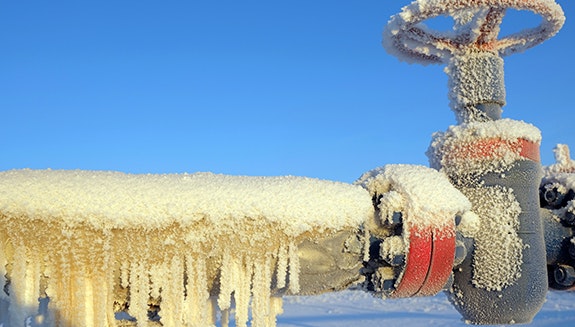

Plants need to make preparations for arctic weather even if they only face such conditions very infrequently. That’s a cold hard fact now abundantly apparent to facilities in Texas and elsewhere on the Gulf Coast. Because protection against intense cold isn’t needed every day or even every year there — more like every decade or two — over time attention to detail may lag and systems may degrade. However, failure to protect can have serious consequences.
The biggest problems come from water. The expansion of water when it freezes can cause burst pipes. Burst pipes affect not only houses but also plants. Frozen vessels and water-filled pipes can rupture. Even if water plugs don’t burst the equipment, the ice formed can break open flanges and force leaks. Loss of integrity from freezing has led to major fires and environmental releases.
