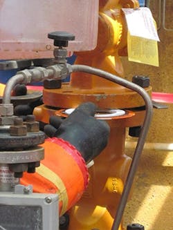

Gasket In Place
Figure 1. Proper flange separation allows for uninhibited insertion of gasket.
