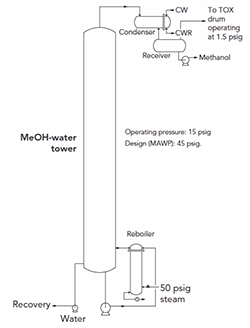

August’s Puzzler
An engineering firm we hired disagrees with me about pressure relief on a methanol/water/formaldehyde column (Figure 1). The company is adamant that we must size and install a relief valve for two-phase flow.
Methanol/Water/Formaldehyde Tower
Figure 1. The need for a relief valve is a bone of contention.
The distillation tower operates at about 15 psig and has a design pressure of 45 psig. The tower recovers at the condenser about 99% of the methanol along with a few percent of formaldehyde and water. The methanol gets recycled back to the formaldehyde plant. Some trace vapor travels through 110 ft of 1-in. pipe before passing into a 16-in. vent to a thermal oxidizer (TOX).
After I heard from the firm’s engineer whose analysis indicated the relief valve was necessary, I did a fire-sizing calculation myself and then computed the choked flow for the 1-in. vent from the receiver to the TOX knockout drum. I found the choked flow capacity far exceeds that required for fire sizing. My engineering report disparaged the loss of methanol to the TOX but concluded that no relief valve is needed.
The firm’s relief expert counters that I can’t take a reduction for four inches of fiberglass insulation in a stainless steel jacket; he says fiberglass may burn. Without that reduction, the flow capacity is much greater than the choked flow. Besides, he contends, two-phase flow, not vapor, will exist in the 1-in. vent. He also notes that he must look at other scenarios. Initially, he challenged my engineering report by mentioning the vent line could have an isolation valve — thus, necessitating a relief device. However, the line to the knockout drum doesn’t have a valve. He also stated the relief must be on the tower, not the receiver.
In addition, the expert says the vent system might not be capable of handling the flow of all the vessels connected to it if a site-wide fire occurred. I told him we don’t assume the entire site is on fire to size a vent for a relief flow.
What do you think? Do we need a relief valve on this distillation tower? Is the 1-in. vent adequate? Are there any other scenarios worse than a pool fire that could result in a large relief flow? Is two-phase flow in the vent likely or is it just something the experts wants to consider to reinforce his argument?
