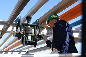

Figure 1. Portable device provides both efficiency and easy operation by one person.
After some research, we discovered the BobbyJack and decided to use it to support such activities (Figure 1). Key features that make this option attractive include:
Safety. The BobbyJack pipe-lifting device offers distinct advantages over conventional pipe-lifting options such as cranes/slings and chain falls because it’s completely within the control of the person lifting the pipe; lifts are made gradually with the jack and you don’t have to rig off other pipes.
Portability. The unit can go almost anywhere it’s needed with minimal clearance requirements. A small “lifting crew” can manage it with no additional manpower support.
• Efficiency. Because the person doing the lift manages the jacking system, other resources like cranes and additional craft support aren’t needed.
Ease of operation. The system is easy to understand and operate. With only minimal training and experience, lifting crews can be qualified to make pipe lifts safely and effectively with it.
Using the BobbyJack pipe-lifting tool is a simple 10-step process:
1. Check the thickness of the top flange of the pipe support. (BobbyJacks are designed specifically to work with I beams or opposing C-channels). If the flange is less than ½-in. thick, install a box shim on the hook and secure in place with a shim-retaining pin (all parts included). If the beam is ½-in. thick or greater, don’t use the shim.
2. On the pipe to be lifted, place one of the support arms of the BobbyJack across the top flange of the beam.
3. Pull the arm toward you to fully engage the support arm until it’s fastened onto the opposite side of the beam.
4. Swing the pivoting brace until it’s directed at the lower inside corner of the beam between the web and the lower flange of the beam.
5. Adjust the length of the screw as required to ensure the support arm lies flat across the top flange of the beam.
6. Repeat this process for the second support arm, positioning the two arms at least 12½ in. apart.
7. Position the lifting cradle/riser assembly into the vertical slots on the support arms.
8. Place the hydraulic jack into the lifting cradle and lift the riser about 2 in. to allow the rounded cap at the top of the jack to slot into the round socket of the riser.
9. Insert the jack retaining pin through the hole in the base of the jack and the matching hole in the base of the lifting cradle.
10. Put the appropriate lifting “vee” on the riser assembly and lift the pipe.
You can insert a locking mechanism into the assembly. This eliminates the possibility of the jack allowing the lifted pipe to fall back onto the support; it is a great safety feature.
