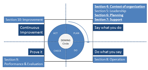

Figure 1 summarizes the key changes between ISO 9001:2015 and its predecessor. The solid, underlined sections denote where the enhancements have been made.

Figure 1. The 2015 version of ISO 9001 includes important revisions in several sections.
