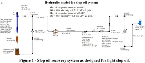

We use a vertical turbine pump to move slop oil from a sump to a steam stripper (Figure 1). Everything worked fine until we had a recent turnaround. When we started the next day, the stripper column began to rattle. It sounded like cavitation. The pump was operating fine, although closer to its thermal deadhead point. In addition, I noticed the feed flow control valve opening to the stripper rose about 20%, from 71% open to 92% open for 60 gpm. The operator raised the temperature set point from 240°F to 250°F but the noise in the tower continued. Shortly after the operator changed the set point, we observed cavitation in the pump and shut it down temporarily to clean the suction strainer; fortunately, we could switch to a spare pump. The mechanics won’t have the suction line broken down for an hour or so. What do you think caused the problem with the pump and tower? Should we be worried about this during normal operations?
Slop Oil System
Figure 1. System worked fine before a recent turnaround.
