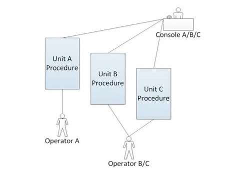

Figure 1. Different operators often require different procedures or portions of them.
Unit centric. Despite the increased interest in procedures, the basic approach, formatting and usability haven’t changed or improved. Procedures still are written so there’s one for each event for each unit. This creates a variety of problems. Some events are common to multiple units (e.g., power loss), so multiple procedures will be needed when the event occurs. While a single field operator may handle a given unit (which is not universal), multiple operators may oversee a large unit, or a field operator may look after several units. A console operator likely will keep an eye on multiple units unless a single unit is large. In these cases, one operator often will need multiple procedures to respond to a single event. If the unit is large, only a small portion of the procedure will be relevant to each field operator (Figure 1). Finally, some procedures really are subsets of larger ones — e.g., those for the loss of a steam-turbine-driven compressor really are a subset of the ones for a steam failure.

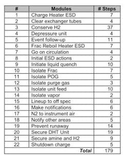

Eliminate duplication. It quickly became clear that the amount of unique content in the procedures was very small. It also became apparent that the procedures contained numerous inconsistencies and inaccuracies. For instance, “charge heater” steps occurred in more than half the procedures related to the field operator’s tasks but often were described differently (Figure 2). Wouldn’t it be better to create the best description of the common charge heater steps and use it everywhere? The one exception is the last event, tube failure, where the damper opening is unique; “open the damper” would become its own module.
The exercise clearly showed that voluminous procedures aren’t necessary. Fifteen emergency procedures were reduced to 22 task modules totaling 180 steps (Figure 3). The amount of unique text in the procedures (not including any background or training information that should be stored elsewhere) amounted to only 10% of the original volume. The emergency procedures drew upon different combinations of the modules to produce more than 40 pages for a single unit. The unique content of the modules filled less than 4 pages.
Position centric. Just as important, it was easy to create procedures tailored for each operator. The console operator would have a single procedure for a power failure rather than the seven procedures currently necessary in such an event. This was achieved by placing the modules into a relational database. Figure 4 illustrates the basic design — tables define: 1) which units are a given operator’s responsibility; 2) the modules that apply for each event on a unit; and 3) the steps and supporting material for each module.

Figure 3. Fifteen emergency procedures were reduced to less than 180 steps involving 22 tasks.
