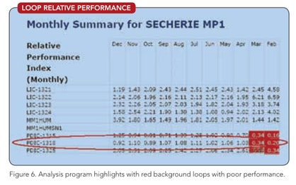

One of the simplest ways to address energy efficiency through automation is to routinely review the performance of regulatory control loops that affect energy consumption. Examples are steam/oil ratio controls in oil-fired furnaces, steam pressure controls for sub-headers or individual heat exchangers, plant air header pressure controls, etc. Often, operations doesn't flag these loops for attention from process control staff as long as their performance doesn't impact production rate or final quality. Identifying such loops and periodically focusing on them frequently can improve energy efficiency without affecting the overall process. Routinely checking for poor controller tuning, valve stiction and transmitter problems can yield benefits for many plants.
Figure 6 shows a capture from an automated performance evaluation of proportional-integral-derivative loops at one site. The program identified several loops (highlighted with a red background) as having poor performance. Prior to the automated analysis, neither operations nor controls personnel had flagged any of the loops because their poor performance wasn't causing any noticeable problems in the unit. Addressing only one of those loops, PDIC-1318, to improve its performance, reduced steam consumption by over 1,000 kg/hr.
