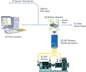

Figure 1. Battery powered units mount directly on machines and can collect a variety of data.
Taking First Steps
The trial focused on two problematic high-output fans. First-pass troubleshooting pointed to design flaws with their base structures as the apparent cause of repeated fan failures. A massive (and costly) redesign of each base was considered inevitable.
During the trial, fan operating parameters were monitored using the SKF Wireless Monitoring System V/T (Figure 1). These battery-powered eight-channel units directly mount on machines to collect data on acceleration, velocity, temperature and bearing condition, including spectral data for automatic upload for viewing and analysis. In this case, analysis of vibration data showed the base structure wasn’t the source of the problem. Instead, the plant discovered — and then verified — that cavitation in the ducting was the root cause of premature bearing (and fan) failures; this eliminated any need for a redesign of the fan base and any outlay of associated capital.
The trial’s success spurred expansion of condition monitoring throughout the facility. The critical assets now under constant online surveillance include dozens of cooling pumps, hydraulic pumps, scrubber pumps, high-volume fans and blowers, paddle mixers, electric motors and cage mills. All are monitored 24/7 by the SKF Multilog On-Line System IMx-S (Figure 2).

The SKF IMx-S technology monitors multiple components in designated critical assets. For example, the system’s dual sensors (vibration and temperature) applied to an overhung fan keep watch on two motor bearings, two shaft bearings and one tachometer using eight analog channels and one digital channel. Data are wirelessly transmitted within a 100 ft. radius to a strategically located wireless network point in the plant.
Each sensor in the drive train has a predetermined warning and caution threshold. A simple visual “stop light” indicator (red for warning, yellow for caution and green for normal) appears on the system’s graphical interface on LCD screens in the reliability offices and the operations digital control center. When a threshold is exceeded, the indicator turns yellow or red; an overview screen pinpoints the source and allows a reliability technician to access a photo layout of the actual asset with stop light indicators showing temperature and overall inches-per-second parameters. This allows the person to quickly identify the questionable part of the rotating assembly.
