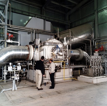

For example, using the thermodynamic model of a multi-stage compressor (Figure 1), specialists can determine the current performance of the overall compressor, on each stage of the compressor and, if there are inter-stage coolers, the performance of those coolers as well. In addition, they can define the negative impact of each one of those different sections of the compressor on the machine’s overall performance and show what it’s costing to drive the compressor or how the compressor’s throughput has been reduced (Figure 2).
Figure 1. Fouling due to the rapid build up of deposits of gas and air causes compressor performance to suffer.
