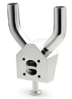

Figure 1. Three options are available, with configuration C, depicting a block body assembly, the best.
In Configuration A, a tee fitting with three welds creates a horizontal line to a valve. The deadleg is the area between the tee fitting and the valve. This arrangement creates the longest deadleg of the three options because the valve’s proximity to the intersection is limited by the tee stub. When selecting this configuration, a designer’s best approach is to choose tees whose stubs are shortest in length and widest in diameter, which will facilitate access when cleaning and minimize the area for fluid hold-up.
Configuration B uses a valve instead of a tee fitting. The tee is created by boring a hole into the side or bottom of the valve. A vertical line is welded into the valve to create the tee formation. The distance to the valve on the vertical line (the dead leg) is now shorter than in Configuration A because the welded tee fitting is not part of the flow path.
Configuration C eliminates the deadleg altogether through the use of a custom valve assembly. In these assemblies, two valves actuate from the same block, one controlling vertical flow and the other horizontal flow. Block body assemblies can be produced more cost efficiently by some companies than manufacturing two valves separately.

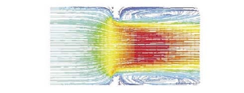

The common four-bolt ANSI flange is unsanitary and therefore inappropriate for biopharmaceutical and other sanitary systems. The conventional ISO-2852-type tri-clamp fitting can be employed but poses issues of drainability and flow obstruction. As the clamp tightens, the gasket will extrude into the interior flow path. With thermal cycling, the bore intrusion may increase. Computational fluid dynamics (CFD) shows that such intrusion causes turbulence in the flow path and potential hold-up when the system is drained (Figure 5).
Figure 5. CFD shows how an ISO-2852 tri-clamp fitting can suffer from gasket extrusion into the flow path.
Fittings of an alternative design, such as the TS series, preclude gasket extrusion into the flow path by preventing over-tightening and providing an alternative space into which the gasket may extrude (during pull-up and clamping) or expand (during thermal cycling).
