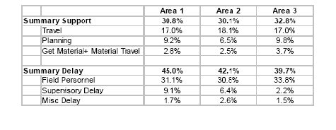

Additionally, the data can be grouped to summarize support and delay activities by area of the plant (Figure 2).
The compiled data allow us to assess and report results by loss categories and use this in cause-and-effect analyses to identify improvement opportunities and address loss percentage levels in each subcategory. The data summaries calculate direct activity percentages and break down observations by indirect subcategories for reporting and improvement planning. Figure 3 illustrates a typical format for presenting these data.
