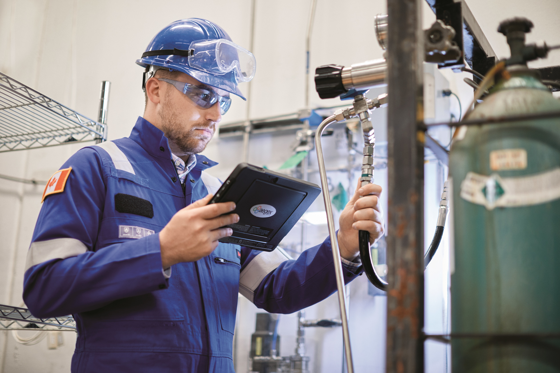

2. Track the lifecycle of each hose
Once the audit is complete, create a regular schedule surrounding hose inspections, using the supplier recommendation as a starting point (Figure 2). Most scheduled inspections are strictly visual, seeking to find signs of wear, such as kinks, cuts, general deterioration, corrosion or scrapes. Fortunately, these routine inspections can alert operators to hoses that must be replaced before catastrophic failures and rarely require system downtime. During these inspections, record the observations in the master spreadsheet, including the service interval. Keeping such historical information for each hose can inform future purchasing decisions.
Also, closely observe and record hose-failure details, including the severity, location and the mounting of the hose. Paying attention to these details will allow an appropriate post-mortem and future action plan to ensure such a failure does not happen again.

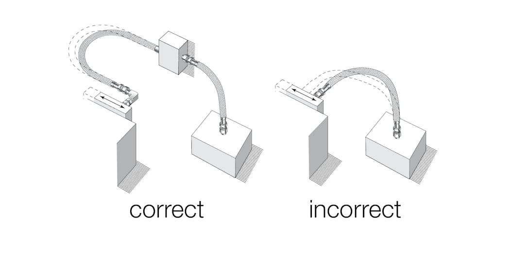

Hose strain is a common problem involved in refinery or processing plant operations. During the regular inspections, observe and record conditions that provide additional strain to the hoses and remove them when practical. Examples of strain include exposure to external heat sources, pulsation, friction with other equipment or obvious design flaws.
Common causes of hose strain include:
  • Twisting a hose or bending it on more than one plane (Figure 3) can increase strain on the hose and cause unnecessary wear
  • Bending a hose beyond its recommended radius can cause premature failure due to the increased strain on the hose
  • Bending a hose too close to the fitting connection may also cause premature failure due to the added strain
  • Using too short of a hose can cause increased strain during impulses
  • Neglecting to use elbows and adapters on horizontal end connections to relieve hose strain can also cause premature failure
