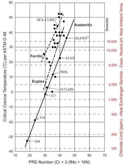

A classic example is chloride pitting of the 304 and 316 austenitic stainless steels. These materials are very popular for heat exchanger tubes and plate-and-frame HX components. Stainless steels owe their corrosion resistance to the oxide layer that forms on the surface per the addition of 12% or more chromium to the alloy. Stainless steels need a constant supply of oxygen to maintain this protective layer. However, chloride ions can penetrate the oxide film to establish localized corrosion cells. Consider the following personal case history.
Case Study: Stainless Steel Selection Pitfalls in Power Plant Design
For several years, one of my primary tasks was to review the water treatment portion of engineer, procure, construct, or EPC, specifications for combined cycle power plants. These specs came from outside design firms. Almost without exception, the design engineers would select 304L or 316L stainless steel as the tube material for the steam surface condensers.
But in numerous instances it was clearly obvious that the design team had not considered the potential for chloride pitting.
Corrosion knowledge has advanced greatly over the years, and it is now known that even seemingly low chloride concentrations (approximately 200 mg/l for 304L and 500 mg/l for 316L) can induce pitting corrosion, especially underneath deposits.2
Because most modern cooling systems have a cooling tower at the heart, all impurities, including chloride, cycle up in concentration due to evaporation from the tower. While the makeup water chlorides may be below corrosive concentrations, the recirculating water may be well above.
Chloride pitting resistance is frequently the primary factor in heat exchanger materials selection for water-cooled exchangers. A well-known guide is the pitting resistance equivalent number (PREN) chart as shown in Figure 4.
Higher-alloy materials beyond the 300 austenitic stainless series are recommended for cooling waters with appreciable chlorides. For highly brackish water and seawater, the ferritic and super-ferritic alloys are often recommended. Consider another important and insidious pitting example. As we will further examine in the microbiologically influenced corrosion (MIC) discussion below, sulfides can be extremely corrosive to many metals. Figure 5 shows sulfide pitting in an extracted and longitudinally cut section of a 90-10 copper-nickel condenser tube.
