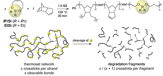

Cleavable Monomers
Figure 1. The introduction of x cleavable bonds within the strands of pDCPD with c crosslinks provides degradation fragments with ⟨c/(x + 1)⟩ crosslinks per strand. Source: Jeremiah Johnson, MIT.
