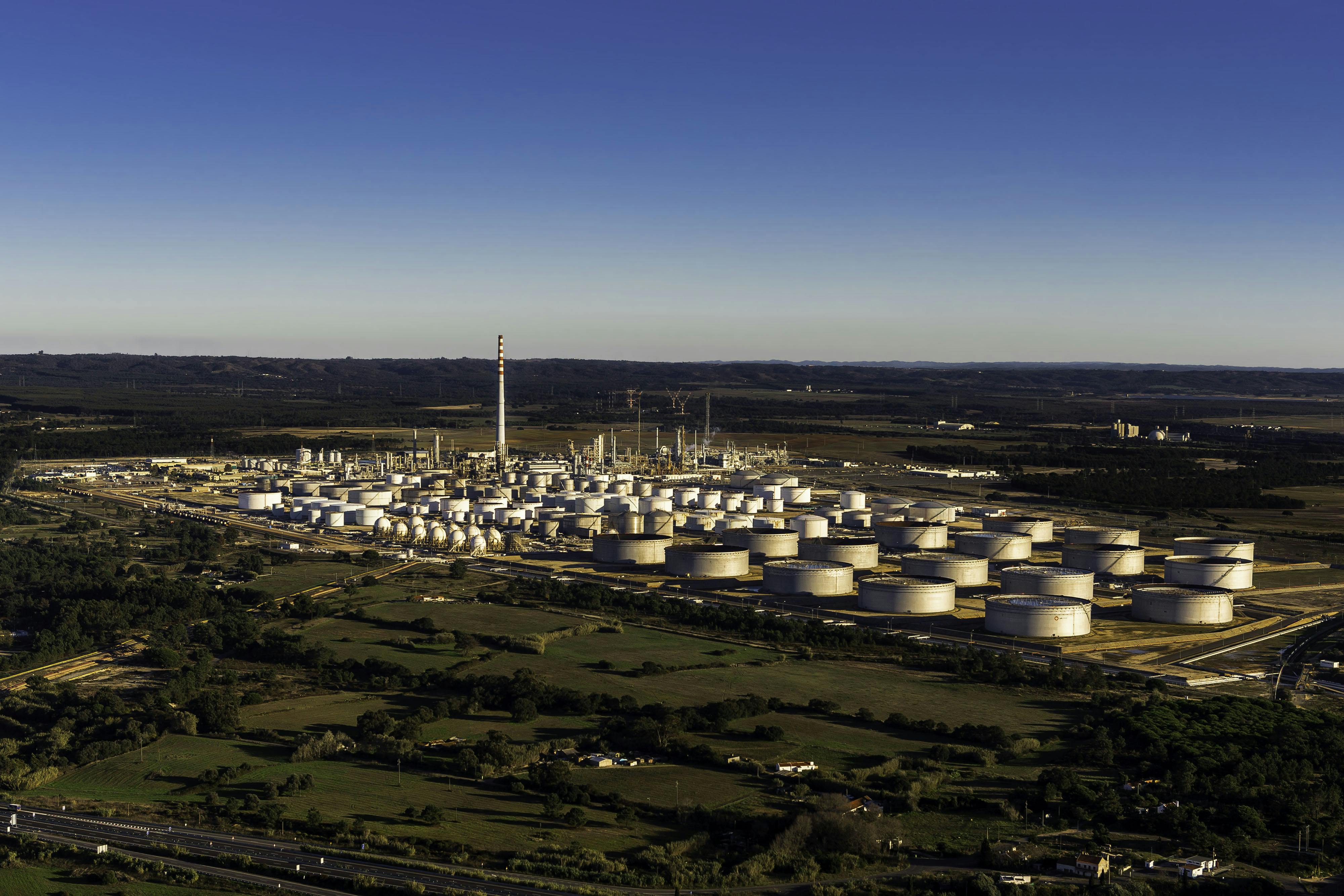

Also in September, energy company Galp, Lisbon, announced it will invest in two large-scale projects worth €650 million ($711 million) to reduce the carbon footprint of its ZILS refinery and associated facilities (Figure 3).
The two projects are a 270,000 t/yr advanced biofuels unit, to be built in partnership with Mitsui, and 100 MW of electrolyzers to produce green hydrogen. Both units are expected to have 2025 start-ups.
The biofuels unit will use waste residues to produce renewable diesel (hydrotreated vegetable oil) and sustainable aviation fuel, together estimated to reduce the equivalent fossil fuel emissions of CO2 by 800,000 t/yr.
The electrolysis plant will replace approximately 20% of the existing grey hydrogen consumption of the refinery, reduce CO2 emissions by an estimated 110,000 t/yr and use recycled industrial wastewater as a raw material.
