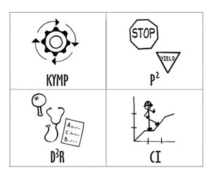

Four Elements
Figure 1. Operator care involves four distinct but complementary aspects.
Operator care has four elements, illustrated in Figure 1, that create a hybrid operator who is comfortable in the operations, maintenance and engineering worlds:
KYMP — Know Your Machine and Process. Operators increase their knowledge of their process and their machines. This may go well beyond current knowledge requirements.
P2 — Prevent or Postpone Failure. Activities to avoid failure include lubricating equipment, hands-on cleaning, tightening bolts and making minor adjustments. We consider this to be basic maintenance work.
D3R — Detect Defects, Diagnose and Report. Inspections directly resulting from the hands-on cleaning activity identify any deterioration or defects.
CI — Continuous Improvement. The operator always is involved in thinking about how to make the equipment work better. Potential improvements may come from reduced downtime, increased yields and lower utility usage. CI is an adjunctive engineering activity.
