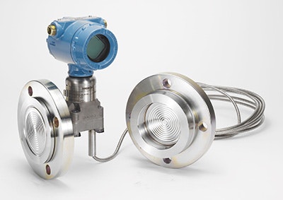

This type of remote diaphragm seal withstands the pressure and other attributes of the process fluid including its temperature and corrosiveness. The remote diaphragm seal moves in response to the system pressure and transfers that action to a fluid-filled capillary line that goes to the pressure transmitter. The remote diaphragm seal becomes the process containment point. Let’s examine how this works in greater detail.
Diaphragm Seal
Figure 1. Such a seal uses a large diaphragm to transfer pressure to a fill fluid and prevents problems caused by process fluid directly contacting the instrument.
A Versatile Approach
Diaphragms can serve as remote seals (Figure 1) in many pressure measurement applications that can accommodate their physical size. They can support gauge, absolute or differential pressure (DP), which extends potential use to flow and level measurements. Generally, a remote diaphragm seal is installed via a threaded or flanged connection, with available sizes ranging from ¼-in. NPT to 4-in. ASME flange.
The diaphragm surface area and stiffness determine the amount of pressure applied to the fill fluid, which must correspond to the process pressure so the instrument reacts correctly. Because it directly contacts the process, the remote diaphragm seal must be chemically compatible with the process fluid to avoid corrosion and other problems. If specialized alloys are necessary, only the remote seal assembly must be made of the costly material — unlike conventional impulse lines that require the material for their valves and fittings.

After discussing all the advantages of remote diaphragm seals, we also must recognize that they can fail. Getting responsive and accurate readings requires thin diaphragms to transmit pressure. While the fill fluid provides even support, the diaphragms remain susceptible to corrosion; so, careful material selection is essential. Actual field failures, if analyzed appropriately, can provide important insights because the information gained can reflect on both the process and the equipment. Therefore, using the proper examination methods to analyze a failure is crucial for determining the true root cause.
The most common cause of failure involves an instrument being pushed beyond its design limits. This can occur for a variety of reasons. For example, the process fluid is more corrosive or erosive than expected. This can stem from a difference in chemistry, inclusion of abrasive solids, increases in fluid velocity and other factors. Consequently, the service life of the diaphragm declines.
These cases often reveal things about the process that operators didn’t realize or fully understand. However, in many cases determining the root cause depends on sophisticated testing methods. A vendor, through its analysis capabilities, often can help in pinpointing the culprit.
Most failures associated with remote diaphragm seals involve the diaphragm itself at the point of contact with the process fluid. Drawing on a wide collection of sophisticated tools is critical to determining failure mechanisms. Some are observational while others attempt to recreate circumstances of the failure. The most frequently used tools and methods include:
