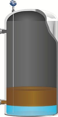

Important Interface
Figure 2. When emptying a tank filled with multiple liquids, knowing the interface level is necessary to avoid cross contamination.
Multiple Levels
Some applications require a continuous reading of the liquid level in a tank containing multiple products that separate into layers (Figure 2). Level switches can do part of the job, as just discussed, but the distance between the switches restricts measurement resolution. So, a plant should consider other options. The three main choices capable of measuring overall level as well as the interface below the surface are: magnetostrictive, guided-wave radar (GWR) and differential pressure (DP).
Magnetostrictive and GWR are somewhat similar in approach in that they both send an electronic pulse down a probe and calculate level based on the time of flight to the liquid surfaces and back. With a magnetostrictive instrument, the pulse is reflected by a float that is free to move up and down the probe, buoyed by the liquid to follow any change in its level. Floats come in different buoyancies and are chosen based on the specific density of the liquid. So, to locate a water/oil interface, the lower float is carefully tuned to float in water, whereas the upper float has greater buoyancy to float on top of the oil.

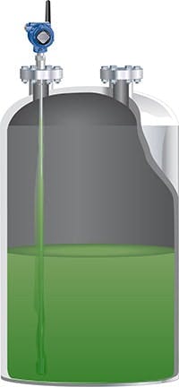

GWR also sends a pulse down a probe but doesn’t use a float. The pulse is reflected directly off the surface of the liquids (Figure 3) — the main reflection from the top and a secondary reflection from the interface layer. This works provided the liquid on top has a lower dielectric constant (DK) or relative permittivity than the liquid underneath. GWR suits sensing oil on water well because most oil products have a very low DK, <5 typically, while water’s is >50.
GWR Measurement
Figure 3. Pulse creates echoes both from the surface and the interface point.

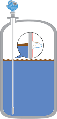

A GWR probe can tolerate some amount of buildup; so, in general, cleaning is unnecessary. Moreover, the instrument can indicate a developing problem of excessive buildup because the nature of the echo created by a dirty probe (Figure 4) differs from that of a clean probe. Some instruments with advanced diagnostics can quantify signal quality and send it as a secondary variable. Should signal quality ever drop below a critical level, an alert can warn operators of the problem so they can take appropriate action.
Clear Warning
Figure 4. Buildup on a GWR probe eventually changes the profile of the echo in recognizable ways so operators become aware of the problem.
