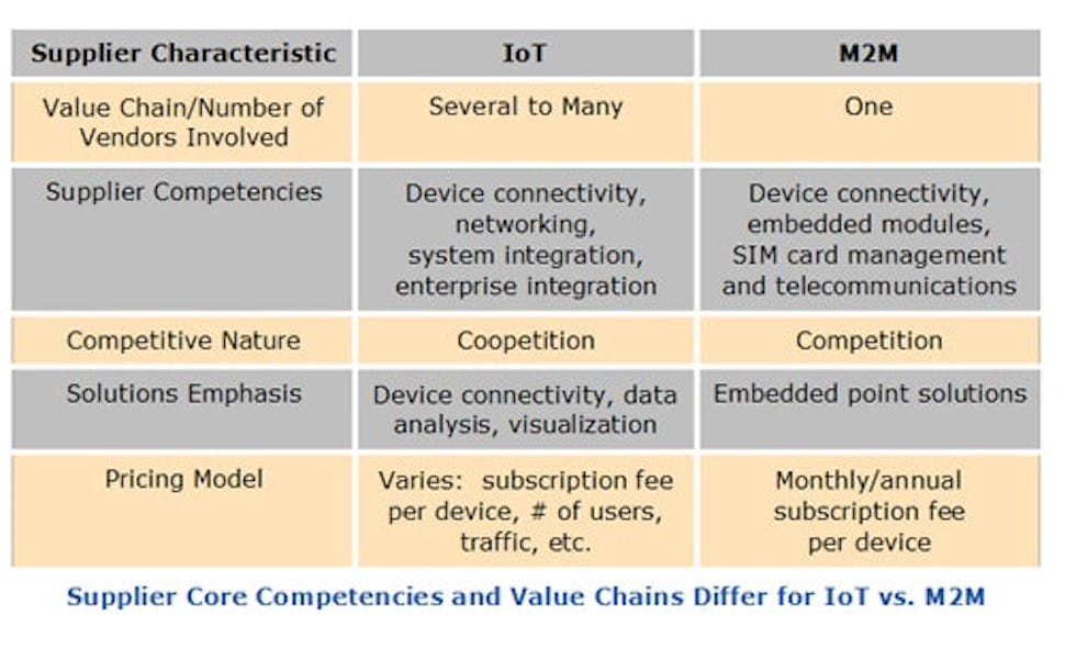

Supplier Characteristics
Supplier Core Competencies and Value Chains Differ for IoT vs. M2M.
Differences in Supplier LandscapeSuppliers of M2M and IoT applications typically have different competencies.  This directly affects users' ability to generate the desired benefits from their remote device access solutions.M2M supplier competencies tend to focus on the "plumbing" aspects mentioned earlier, particularly embedded hardware and cellular telecommunications networks. Many are starting to add cloud capability through internal development, acquisition or partnering. But for most M2M suppliers, this represents new terrain.  IoT solution suppliers, on the other hand, tend to emphasize software capabilities and particularly enterprise integration.  These are important distinctions.Specify the Right SolutionThe terms M2M and IoT have become synonymous in many quarters, but it is important to make sure you specify a solution that meets your current and anticipated needs.  This involves recognizing up-front whether you seek a point solution for simple remote machine access, like in a service-management application, or look to drive incremental business benefits across the enterprise through use of analytics, Big Data and other software-oriented performance-improvement tools.  Enterprise integration capabilities, scalability, software vs. hardware emphasis, and use of standard vs. proprietary device connections are key criteria that impact whether you have an IoT or M2M solution.ARC recently launched a dedicated Industrial Internet of Things (IoT) Advisory Service designed to help manufacturers and other industrial organizations make sense of, evaluate, plan for and potentially implement emerging IoT technology and solutions.
