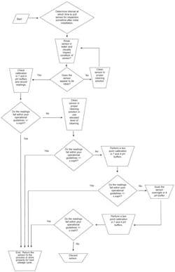

So, whenever possible, users should develop their own maintenance and calibration schedule. It's fairly straightforward to do this.
First, take a newly installed pH sensor out of the process after a set amount of time, perhaps a day or two, to perform a visual inspection. If with the naked eye you find no debris or fouling on the electrode and reference surfaces, rinse the sensor in distilled water and perform a buffer check. This involves placing the sensor in the calibration buffers you typically use. If the sensor reads within the tolerances defined in your operational procedures in the offset (7 pH) and span buffers (4 pH), it needs no further action and can be reinstalled.
Repeat this exercise every few days until you see a change in either the level of debris/foulant on the electrode and reference surfaces, or you get readings that exceed the tolerance. This identifies the interval at which you must perform maintenance.
Now, you must determine whether the sensor just needs a cleaning or a cleaning and recalibration. First, clean the sensor (see below). Then, retake readings. If these fall outside your pass/fail criteria, a cleaning alone won't suffice.
SENSOR MAINTENANCE
Figure 1. This decision tree summarizes the suggested procedure. Click here to enlarge.
Figure 1 summarizes the overall procedure.
