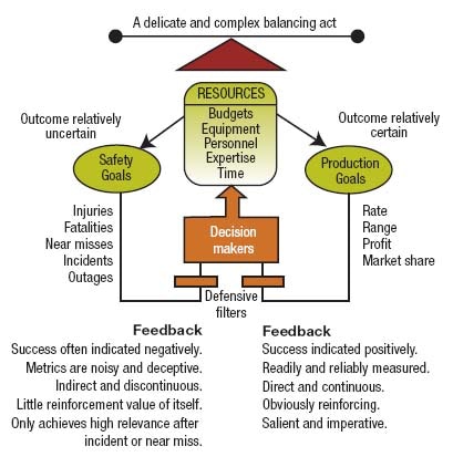

When successful, the instrumented protective system (IPS) is blamed for a process outage; when an IPS fails, it’s blamed for the incident. Within the system, individual instrumented protective functions (IPFs) act to prevent specific hazardous events. When an IPF successfully operates as required, it should be given credit for the event avoided, including potential fatalities, injuries, environmental releases, equipment damage and financial losses. Also, the IPF should be credited when its fault-tolerant design allows equipment failure to be detected without causing disruptions to the process operation.
Figure 1 summarizes the decision-making process, illustrating how available resources must be allocated across safety and production goals. Decision-makers often have defensive filters that affect the receipt and interpretation of information [2].
Figure 1. This overview illustrates the complexity of the decision-making process. Adapted from Ref. 2.
Today’s business climate puts pressure on personnel in a variety of forms, such as production forecasts, budget cuts, resource reductions or colleague retirement.
In the absence of a strong safety culture, production and budget pressure can result in a culture of denial in which the decision-maker’s defensive filter refuses to acknowledge any evidence that doesn’t support production or budget plans. Risk assessment can become skewed, with credible safety recommendations and concerns being dismissed without appropriate consideration. Erroneous assumptions concerning equipment and procedure robustness lead to complacency and an acceptance of increased risk. Often, this is done in the absence of dependable documentation, information and data, or a rigorous mechanical-integrity program.
