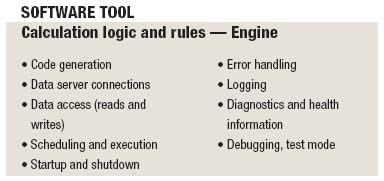

Implementing process calculations using custom client code requires many of the same steps regardless of the chosen platform. Generally, a “programmer-level” individual writes the calculation modules and will need to develop all of the required activities: reading and writing values, scheduling, error-handling, startup and shutdown, logging, testing and debugging. As with most custom solutions, there is usually a long cycle for development and debugging while the core calculation functions are developed, and unexpected behaviors are encountered. Unfortunately, those with the process knowledge aren’t often the ones who write the custom solution. The eventual transfer of calculation logic delays development and may reduce the number of implemented calculations, ultimately limiting the possible benefit of process calculation results.
A calculation engine can overcome many of the problems with custom-written client code (Figure 3).
Figure 3. A “calculation engine” can provide ready templates to reduce the skill level required for programming.
This type of software tool is typically geared toward those with the process knowledge, putting them in an environment where they can easily and quickly create process calculations. These products range from simple graphical-based tools to more powerful scripting solutions. Because many of the required activities are common to all calculations, these “under-the hood” requirements can be separated from the calculation logic. The user can then work on the calculation logic, knowing that the other requirements are already provided in a consistent manner.
The result of this separation can be a reliable process calculation framework, and in the case of the OPC platform, a vendor-neutral solution that can be used across your organization. Not only will you shorten development time but allow a higher volume of process calculations because the ease-of-use. And, those with the process knowledge will be directly involved in preparing the calculation software.
