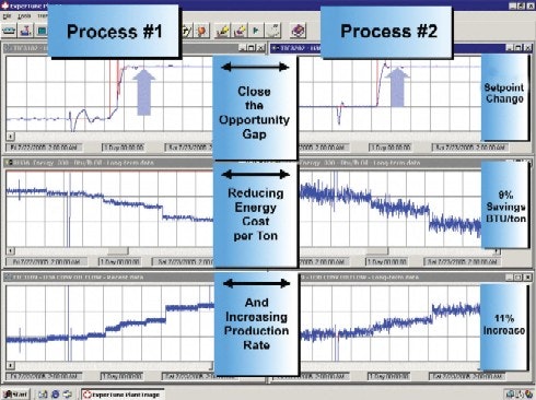

One key performance indicator is the “Opportunity Gap.” This diagnostic recommends shifts in setpoints to drive the plant toward its optimum performance. It works by comparing current setpoints and variability to the desired product specification. As you reduce variability through process improvements, the opportunity gap widens, creating the potential for direct savings.
Figure 2 shows how the opportunity gap was used to increase performance of an oil burner operation. In this case study from a chemical plant in the U.S., energy cost per ton was reduced by 9%, and production rate was increased by 11%.
Figure 2. Reduced costs can be quantified from the process data, such as energy cost and production rate.
