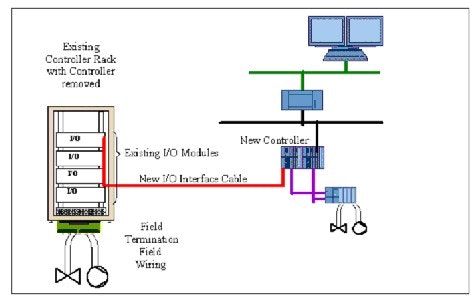

9. I/O interface
This strategy enables the new controller to use an existing I/O subsystem (field devices, racks, terminations and I/O modules) and, so, saves considerable rewiring costs (Figure 9). The legacy I/O stays in place and the new controller interfaces with it. The old controller is removed.
Figure 9. Use of existing field devices, racks, terminations and I/O modules avoids significant rewiring costs.
Hurdle: Similar to the I/O replacement solution, the I/O interface strategy requires a special board that fits into the old controller backplane. The good news is that only one board per controller is needed.
Suggestion:  In most cases, the incumbent vendor is the first place to turn for this kind of solution.
