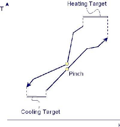

During the late 1970’s and 1980’s tools were developed for the design of heat exchanger networks.  Perhaps the best known tools of Process Integration are the composite curves, Figure 1.  The composite curves give in a single picture the cumulative cooling and heating requirements of a complete process.  The overlap between the composite curves provides a target for the heat recovery opportunities.  Those duties that cannot be satisfied by heat recovery must be serviced by external heating and cooling utilities.  The construction allows a target to be determined for the maximum heat recovery, and thereby the minimum external utility requirements.
Rather than determining the minimum heating and cooling requirements by constructing the composite curves, as shown in Figure 1, it is also possible to calculate the same targets using a non-graphical approach known as the Problem Table Algorithm.  The Problem Table Algorithm follows a step-by-step analysis of the heat follows through the problem from the highest to the lowest temperatures, maximizing heat recovery as heat is cascaded through the system from high to low temperatures.  The composite curves and the Problem Table Algorithm provide the same basic information, but via different routes.  The Problem Table Algorithm is more amenable to implementation within computer algorithms, but the composite curves provide insights into the process that cannot be obtained from the Problem Table Algorithm.
