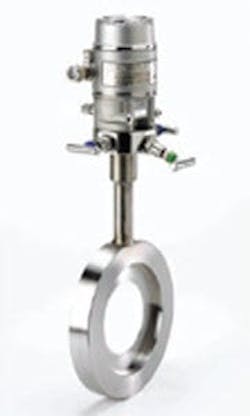

OriMaster is a one-piece flowmeter that comes fully factory configured and pressure tested. Suitable for clean liquids, gases and steam applications in line sizes from 1 in. to 8 in. (DN25 to DN200) and at pressures up to 1,450 psi (100 bar), OriMaster combines all the major components needed for an orifice plate installation in one assembly, typically cutting the cost of installation and commissioning by up to 50%. ABB offers two orifice bores for each pipe size. The flowmeter comes in two versions: one for volumetric readings (OriMaster V) and the other for mass flow (OriMaster M). Both have HART communications. OriMaster M has the additional options of Profibus PA, Foundation Fieldbus or Modbus communications.
