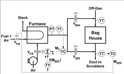

Revised Control Configuration
Figure 3. A summer adds the feedback trim to the ideal value to determine the actual fresh air damper opening.
Consider using the fuel gas valve to control the scrubber duct inlet temperature. The “control each variable with the nearest valve” rationale suggests this valve is “too far away” for effective control. Dynamically, the hot air damper to scrubber duct inlet quickly affects the scrubber duct inlet temperature — but this is only a transient impact with minimal long-term effect. The fuel gas valve affects the scrubber duct inlet temperature more slowly but with a significant long-term effect.
Any change in the fuel flow to the furnace should be accompanied by a change in the fresh air flow. Ratio control is well-known [2], the objective being to maintain a constant ratio of fresh air flow to fuel gas flow. However, because no flow meters are installed, the ratio logic must rely on a characterization function that relates fresh air damper opening to fuel gas valve opening at steady-state conditions.
The data points for the characterization function, which is developed for a specified hot air temperature and pressure, must come from tests conducted on the process. Pressure affects the flow through the various dampers. To eliminate this source of error in the characterization function, control of hot air pressure is essential.
Figure 3 presents control logic that provides the following functions:
1. The scrubber duct inlet TC output (MSDI) is the fuel gas valve opening. The lower output limit should be 30% (which approximately corresponds to minimum fire).
2. The output f(MSDI) of the characterization function (the “TY” element) is the “ideal” value for the fresh air damper opening.
3. The summer adds the feedback trim to the ideal value to obtain the actual fresh air damper opening.
4. The hot air TC adjusts the feedback trim to attain the desired hot air temperature.
The hot air TC must be able to obtain a fresh air damper opening that is slightly larger or slightly smaller than the value from the characterization function. Positive and negative values must be possible for the feedback trim.
For advanced regulatory controls, controller outputs preferably are expressed in engineering units. So, we’ll use “% open” for all valve openings. An output range of -100 to +100% open permits the hot air TC to drive the fresh air damper fully open or fully closed, regardless of the output of the characterization function.
Better Control Configuration
