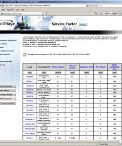

Service Factor Report
Figure 1. Abundance of loops with 0% service factor signals a serious problem.
So where can you get performance information? Most plants have a process data historian actively gathering thousands of pieces of data. Analyzing this information provides great insight into control system performance. Specialized “control loop monitoring” systems can extract the most meaningful data from the process historian (or directly from the DCS) and present these data in a useful prioritized fashion. Let’s now look at a variety of parameters that can give you an indication of performance. Simple MeasuresThree specific factors provide a good starting point for assessing control system performance: Percentage of loops in manual. When control loops are in manual, they aren’t performing their basic function — they’re not controlling. Yet it’s typical to find 30% of control loops running in manual. The loss of control poses safety and environmental risks and, unfortunately, has taken a deadly toll. Furthermore, a loop running in manual usually indicates some other, underlying problem. If a sensor fails, a valve sticks, or controller tuning is unstable, the operator usually will place the loop in manual. A control-loop-monitoring system can provide a complete list of loops in manual, pinpointing many opportunities to improve operation. Valves at limit. When valves are fully open or fully closed, they’re not controlling. The process can wander without any ability to control it. When a valve is 100% open most of the time, it’s often a sign of an under-sized valve. Develop a list of these under-sized valves; you’ll have a great starting point for a debottlenecking study. Many plants have been able to increase production rate simply by focusing on key bottlenecks caused by under-sized equipment.
